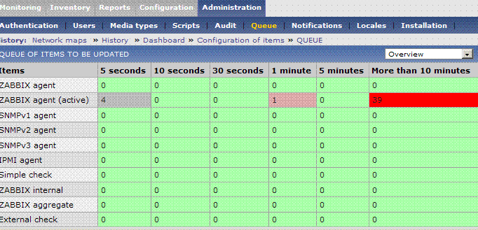

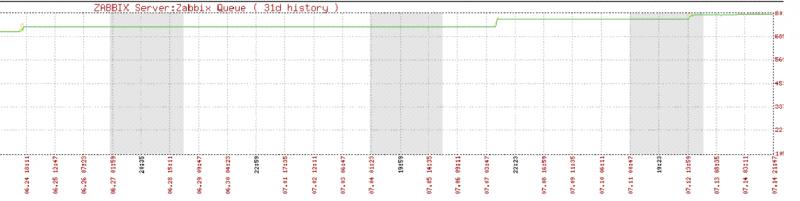

    Hello everyone, I have my Zabbix queue ( zabbix[queue] ) around 750 all the time, however, If I go to Administration -> Queue I only have 39! from 2 hosts that currently offline (see screen). Any Idea what's wrong? Everything seems to work meanwhile
