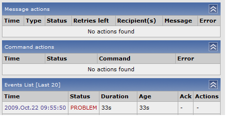

    My action is not being triggererd. Maybe i am doing something wrong.
    I have successfully created a few triggers, they work properly. Then i created an action with the folowing condition; Trigger severity = "Warning"
    When one of the triggers is in "Warning" state the action is not fired. Also when i look at the events the "no action"
    Can someone tell me what is missing here?

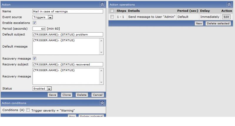

                This is the action configuration;
                • zabbix_zen
                  • Jul 2009
                  • 426
                  For the personalized recovery message work OK you need to add an extra,
                  Trigger value = "PROBLEM" condition
                  either that or uncheck the 'Recovery message' box.
                  and for the scenario you described you don't need escalations do you?
                  Uncheck the 'Enable Escalations' box - you'll only need that when you want to escalate problems to another user if a specified time period is
                  exceeded.

                        hi,
                        i cannot set Trigger severity >= "", i can only choose from the dropdown box (information, warning etc.)
                        i think the trigger works prorperly.
                        Whenever an email action not fired due to the os, firewall or something else out of zabbix' scope, zabbix would still show an action (failed action) or not?
                        • zabbix_zen
                          • Jul 2009
                          • 426
                          I was talking about setting the Triggers severity range in your Action conditions.
                          And yes, you should see the Actions effects on,
                          Administration -> Audit, and selecting Audit Actions from the dropdown button on the upper right corner.
                          You should see a:
                          Status Retries left
                          not sent 0
                          If your Action is triggering OK but there's any problem sending it.
