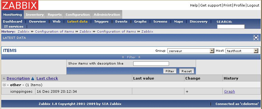

              shouldn't it be multiply by 0.001 to get the correct value?
              but then no value is shown for me (see attached picture), but no error is reported either.
