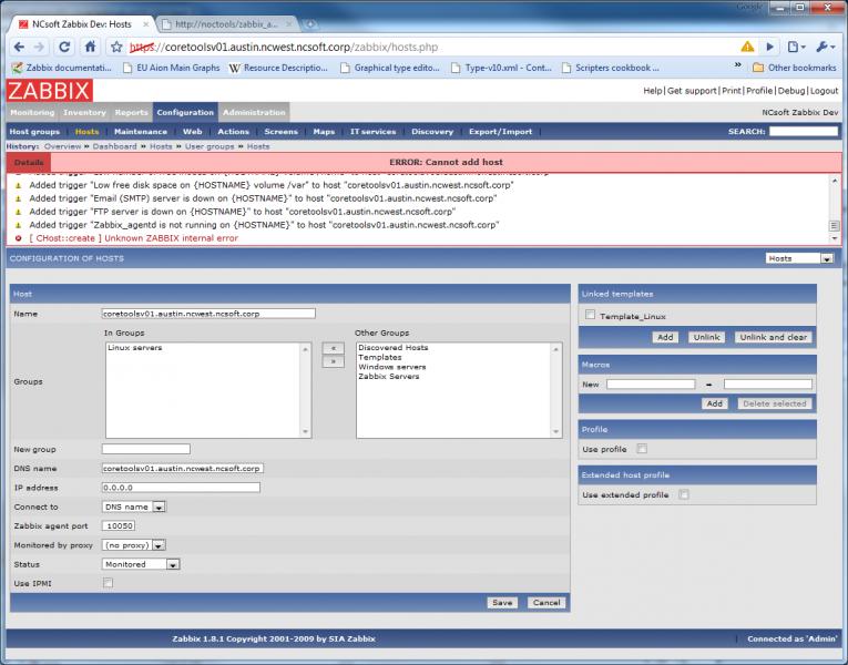

    Unknown ZABBIX internal error (how do I get more info?)
    I've attached a page I am getting. How do I find out more information about this error? I've been getting errors adding hosts to this new installation occassionally and I'm not sure how to proceed in debugging. Screenshot attached.
    Thanks!

          OK, started over and put the Admin user in a Debug group I created with the Debug setting as mentioned. It gives slightly more information:
          The [ Chost::Create ] is new, but still doesn't tell me much.
          I had to replace all the "nvarchar2(2048)" with "nvarchar2(2000)" in the DB creation scripts. Is this related?
          Also noticed post: http://www.zabbix.com/forum/showthre...ight=nvarchar2
          Along with: http://www.zabbix.com/forum/showpost...6&postcount=27
          Seems like a systemic problem with Oracle backends no?
