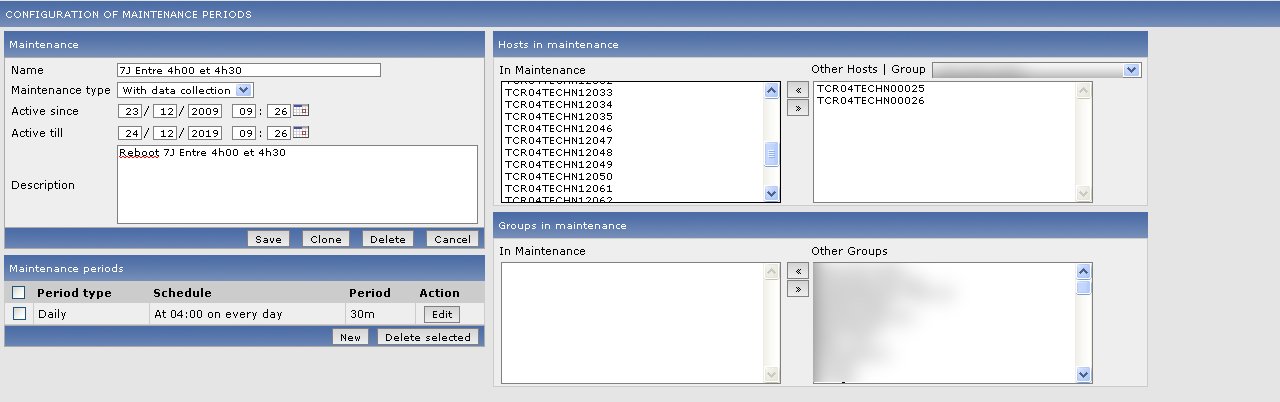

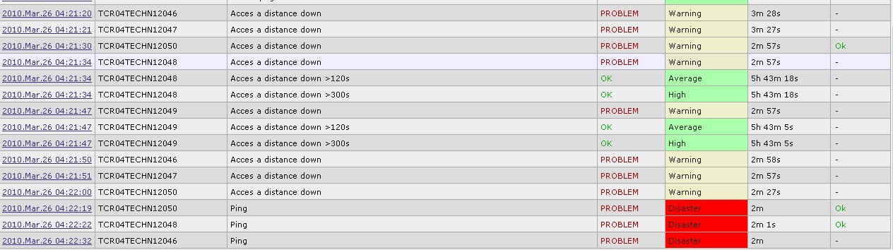

    We installed zabbix 1.8.1 (1.8.0 had the same problem) and since we have systems that reboot every night we used the maintenance periods for those hosts to NOT get called (or mailed) when they reboot. However we're receiving mails for some, but not all, hosts when they reboot during the maintenance period. It seems the "maintenance for host" feature is really broken! I opened a bug report (ZBX-2181) but maybe someone may help with this issue. We will be pushing the new zabbix server into production next week and this bug is a serious blocker for us and could put our use of zabbix in jeopardy (we have over 150 servers and systems monitored).
    I attached screenshots of our config plus the event log where you can see that some actions fired when others didn't when in the maintenance period. It doesn't matter if it's a daily or weekly maintenance, we still get mails when we shouldn't.

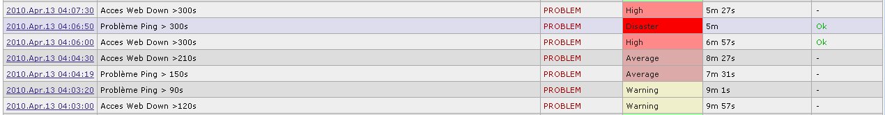

            I looked at the code in timer.c and made some cutoms logs to see if some of the hosts failed to get in maintenance mode. From what I saw Zabbix correctly put the hosts in maintenance mode... however sometimes the actions still trigger and send an email. I attached a screenshot showing the problem :
            - This host is in maintenance from 4h00 to 4h30 for reboot.
            - At 04:03:00, 04:03:20, 04:04:19 and 04:04:30 you can see some triggers kickin' in but due to maintenance zabbix doesn't execute the action (see the dash (-) in last column).
            - At 04:06:00 and 04:06:50 two triggers kick in but this time zabbix decide to execute the action (Ok in last column)...
            - At 04:07:30 another trigger comes on but guess what... no action exectued!! (as it's supposed to be).
            I will continue my search but this bug is killing me... Now I have to wake in the middle of the night almost every day to realize that it's still a false alarm.

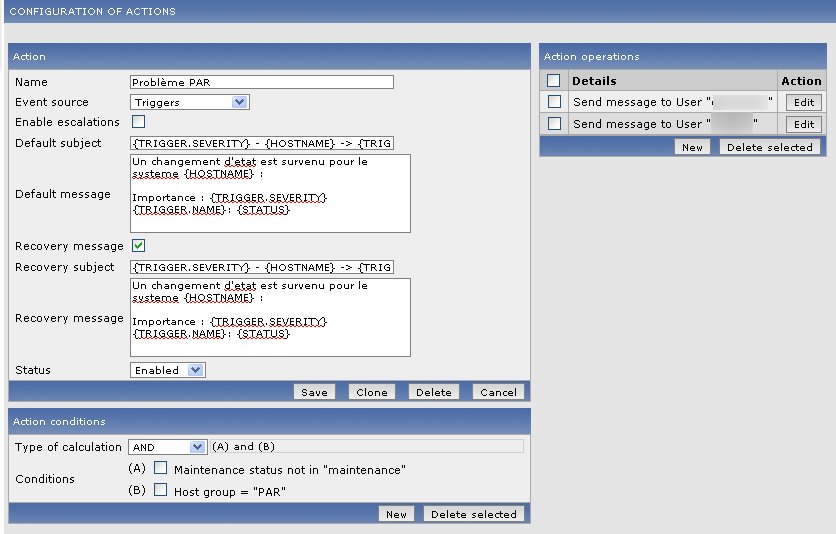

                    I also saw an amelioration in the quantity of false emails received since bug #ZBX-2305 has been recorrected. But the thing that still puzzle me is why does the first action condition is evaluated correctly ("Host group = PAR") and not the two other conditions ("Host group <> Maintenance" & "Maintenance status not in maintenance"). Seems like the event correctly identify the host group for the action but ignore any other condition... weird.

                            Today I have a digging on the forum and found a workaround for this issue.
                            Add one more condition "maintenance status in maintenance" in the action configuration. then the trigger won't send the alert msg anymore when it's triggered during the maintenance period.
