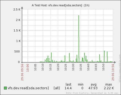

            Richlv, using zabbix_get to pull the vfs.dev.read[device,sectors] value always seems to return the same value for me. It never changes, even after I KNOW my disk has been reading back data.
            In addition, the graph for the item value doesn't show any value above 0. Is your item value actually creating graphs? Can you verify by posting the graph from your 1.8.x interface?
              well, if zabbix_get works, retrieving by server and graphing should also work, so that wouldn't add much value - but hey, just what i won't do...
              that's technically trunk, but hey. note, i'm not saying you all are doing something wrong - it might be something with linux versions etc.
