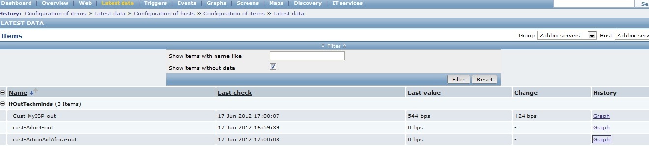

                    I am running zabbix 2.0. and for external checks I have the following:
                    #!/bin/sh
                    LOG=/tmp/zabbix_external.log
                    echo start: $0 `date` >> $LOG
                    echo args: $* >> $LOG
                    ttl=$(snmpwalk -v 2c -c wrongcomm 41.222.XX.XX ifOutOctets.$1  | awk '{print$4}');
                    echo $ttl;
                    echo ttl: $ttl >> $LOG
                    echo end: $0 `date` >> $LOG
                    the log files show the following:
                    start: /usr/local/share/zabbix/externalscripts/zabbix_external.sh Sun Jun 17 16:51:32 EAT 2012
                    args: 503
                    ttl: 8348368
                    end: /usr/local/share/zabbix/externalscripts/zabbix_external.sh Sun Jun 17 16:51:32 EAT 2012
                    start: /usr/local/share/zabbix/externalscripts/zabbix_external.sh Sun Jun 17 16:51:37 EAT 2012
                    args: 939
                    ttl: 2914065543
                    end: /usr/local/share/zabbix/externalscripts/zabbix_external.sh Sun Jun 17 16:51:39 EAT 2012
                    start: /usr/local/share/zabbix/externalscripts/zabbix_external.sh Sun Jun 17 16:51:50 EAT 2012
                    args: 717
                    ttl: 2425176665
                    end: /usr/local/share/zabbix/externalscripts/zabbix_external.sh Sun Jun 17 16:51:50 EAT 2012

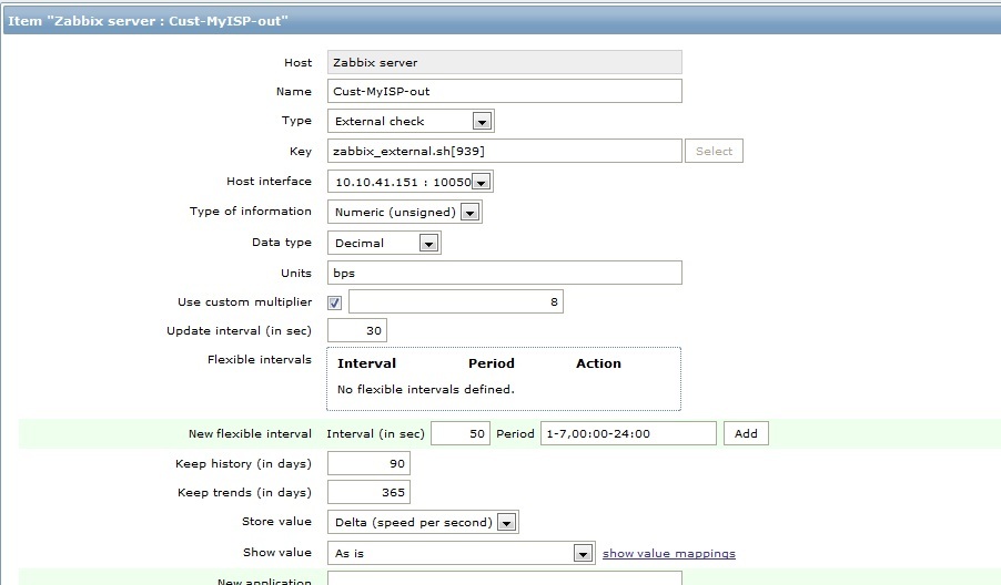

                    On the gui I configured ->numeric unsigned, decimal,multiplier = 8, and units as bps.
                    However only the first one with args 939 registers any value on the front end for graphing. It also happens to be the first one I configured.
                    when checking the GUI,
                    history: Configuration of items » Latest data » Configuration of hosts » Configuration of items » Latest data
                    there are converted values for the one then zeros for all the others. On one I can see a value was picked once then it all went back to the zeroes.
                    If I try running multiple scripts one for each OID, again the first one works, the others all become 'not supported'
                    [code]
                    15817:20120615:211432.166 item [Zabbix server:ifOut.939] became not supported: Received value [IF-MIB::ifInOctets.939 = C
                    ounter32: 1068503185] is not suitable for value type [Numeric (unsigned)] and data type
                    [code]
                    What could I be missing?

                      • matjing
                        • Jun 2012
                        external check works only for first argument
                        ttl=$(snmpwalk -v 2c -c wrongcom 41.222.xx.x  [B]ifHCOutOctets[/B].$1  | awk '{print$4}');
                        okay now I have the same (original) problem for the outbound interface. Any takers? just show's zeroes. These are virtual interfaces with traffic shaping applied
