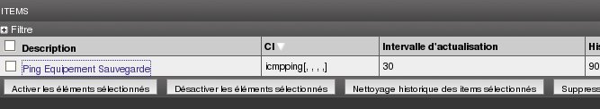

      I'm using simple check Item and icmpping to monitor devices.
      some screen shot

        Try changing your template, so the item is not "icmpping" but "icmpping[, , , ,]" (including the spaces between each comma).
        If that does not work, enable debugging in your Zabbix server (change configfile & restart zabbix server), and monitor the output of the Zabbix server logs for any errors/warnings.

          What do you mean by icmpping[, , , ,] ??? When i do this i have the folowwing error "not supported"
          It's very crazy !!!
          I'm in 4 level debug in my sever configuration .
          Can you be more explicit whit the item icmpping [, , , ,] ??
          When i change the configuration, i have no message in the server log. Ex i just add a new device , who off course is in status unknow, but i have no message in my log

            Did you install & configure 'fping' as well, as defined in the zabbix server config?
            See the 'ping' attachment to know what I mean, with the icmpping command.

              But i try your solution without success. I'm in 1.6 and the icmpping item seems not working like this.
