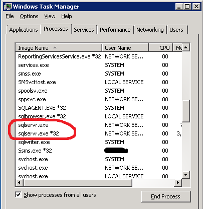

          You can Have MSSQL installed on the same server in 32 and 64bit.
          Like i say Before. If i run MMC /32 perfmon.msc I can Found all my instance in 32 and 64bit.
          if you look at attachment you will see i run Two Process of sqlserver.exe one 64bit and the Other one with *32 are 32 bit.
          So if i read again that post from microsoft http://support.microsoft.com/kb/891238/en-us we have to install zabbixclient in 32bit.
          So the Question, If i install ZabbixClient64 i know i have only access to see 64 bit Perfmance Counter, but if i install zabbixclient 32bit should i see both 32 and 64 bit Performance Counter.
