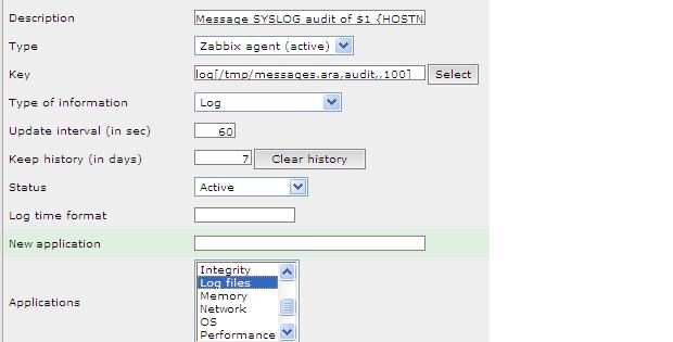

      Hi All,
      I am trying to catch the error message from my logs and I am completely lost.
      I have the server running the latest version of agent (1.8.3)
      I have configured to run "Zabbix Agent (active)" int zabbix_agentd.conf file.
      I have created an Item to catch and parse this error msg in the file :

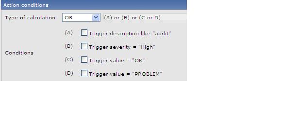

      I have set up this action:

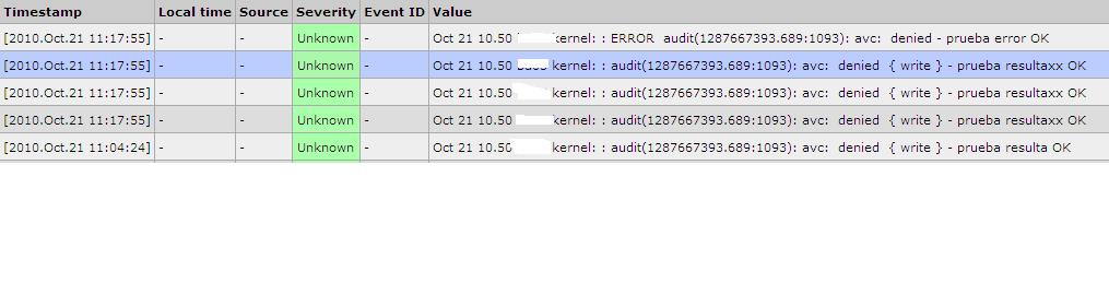

      Here I am attaching how I am seeing the "Monitoring" -> "Latest Data" -> "Log Files":
Name:	action-to-catch error in the log.JPG
      Please any suggestions or comments will be welcome.

          In Zabbix, dependency chain is item -> trigger -> action.
          You have no trigger.
          Check manual for details : http://www.zabbix.com/documentation/...onfig/triggers

            Firstly, RTFM.
            Files":
            You should use Type of information "Text" instead of "Log". "Log" specially created for windows events logging, not for plain text log. As result you will not see Local time, Source, Severity, Event ID columns.
            Others me presented solution - is not original from Zabbix. Be patience to deal with them. Yes, its have possibility fill all columns for Type of information "Text".
            Use two condition Trigger value = "OK" and simultaneously Trigger value = "PROBLEM" this is absolutely illogical. I think you should delete condition Trigger value = "OK".

              Thanks for the recommendation. The situation improved a litte.
              But, now, as you says, I tried to change in the "Item" -> Type of Information: from "Log" to "Text" and I got this error message trying to save the new configuration:
              "Type of information must be Log for log key"
              Any suggestion?
              Thx

                  Now, I am still worried about that...missed, about how to fill in the columns to show the whole message in the "Latest data" view.
                  Because, as the "Severity = Unknown" I can't manage the actions correctly
                  Anyway, thanks for all..at least I am catching and showing the alerts in the console right now ....
