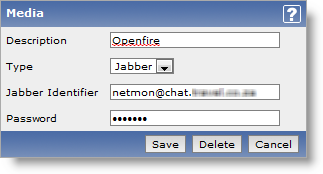

        I am running Openfire on another server, which I use for notifications.
        No scripts are required. Just compile --with-jabber.
        Then create a 'Media' of type Jabber. I use have a 'user' created on the server for this purpose.
        Below is sample of messages received.

            2. In Zabbix configure a Media Type for Jabber. The Jabber identifier should be username@domain (Administration > Media Types).
