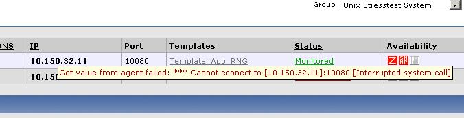

    hi,
    i´m using zabbix server 1.8.2 and agent 1.4.6.
    attached the error message.
    Could it be that the firewall is the problem?
    br,
    zychonatic

    Are you sure you want to connect to Port 10080?
    Zabbix agent uses port 10050.

      yes, i´m still using port 10080 and 10081.
      the port number is right.
      br

        Hi
        can u telnet to this port?
        netstat?

          hi,
          no ican´t telnet this port,
          but i found out, that the routing table is incomplete, so the agent connect with the wrong network interface.
