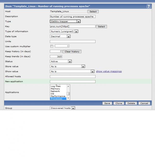

        I change the configuration of the item to be zabbix_trapper. but the problem persists:

        I attache a image of the configuration of my item.
        Any idea to go from here?
        Regards.

          At you screen i see just template "Template_Linux". I'm not sure that you linked this template to host "linux01" (i suppose this is hostname, configured in zabbix)
           -s --host <hostname>     Specify host name. Host IP address and DNS name will not work
          and... why you use IP?

            Hi Zalex_ua
            I solved the question
            Many tahnks to MrKen that point to hte right direction.
            Resuming:
            - The item as to be the type of zabbix_trapper
            - And the zabbix_sender -s option only support the name that is used by zabbix
            root@linux01:/etc/zabbix/external# ./zabbix_sender -s linux01 -z 192.168.1.15 -k proc.num[httpd] -o 1 -vv
