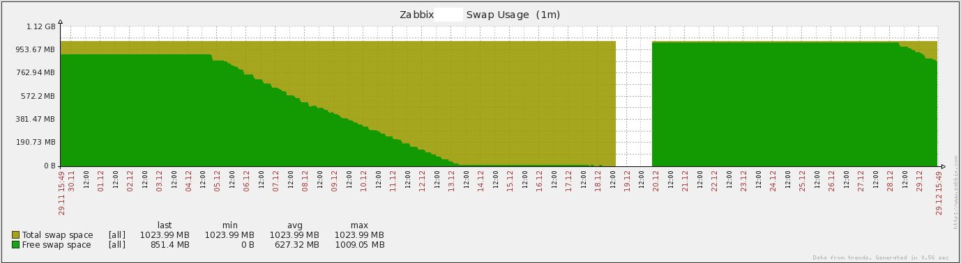

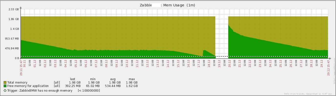

    zabbix_server process quit automatically every 40 days
    Zabbix is a excellent distribution monitoring solution. We deployed a kind of this distribution monitoring environment with two zabbix proxies running on two remote sites. It works well at the very beginning. But unfortunately after first successful month the zabbix_server process quit almost every 40 days, very regularly. We also deployed other zabbix monitoring without proxy. They runs perfectly, no zabbix_server process quit. I suspect it’s a bug of zabbix 1.8.3 isn’t it? I monitoring the zabbix server, found that the memory usage is weird. It seems memory leak. Any suggestion?

        Nelsonab, thank you very much for your reply. I’m sure the process which is consuming most of memory is zabbix_server. I checked the memory status every 2-3 days interval during last several months. Actually, the memory consumed by zabbix_server process grows continuously until run out the memory.
