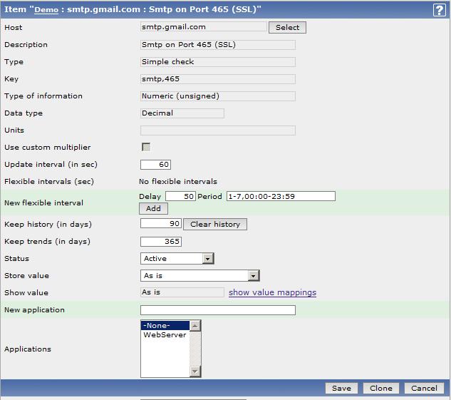

    • fredo2906
      • Jan 2011
      • 14
      Thank you for your reply.
      I have set the item to simplecheck.
      You can have a look at the picture attached.
      What I didn't say is that the check is done by Zabbix Proxy.
      • JBo
        • Jan 2011
        • 310
        It looks OK to me.
        However, I have just checked Google help : smtp on port 465 needs SSL. I think that Zabbix does a simple (non SSL) SMTP connection for 'smtp' check.
        If you just want to know if port 465 is open, you can use tcp,465 instead of smtp,465.
        Hope this helps,
        JBo
        • fredo2906
          • Jan 2011
          • 14
          Thank you.
          Actually I wanted to check the smtp connection with ssl connection.
          I guess you pointed out the issue.
          Fred.
