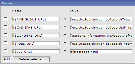

      I'm also attaching a screenshot of how I have my macros configured in the template.

        I have realised the error of my ways. User macros must be specified with a leading $.
        Problem is now resolved.
