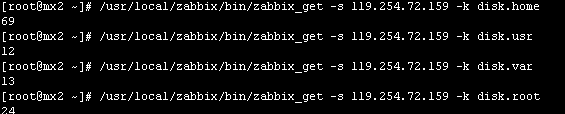

    In addtion,the server(119.254.72.250) can get data from the agent(119.254.72.159)
