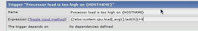

    I could not change a trigger.
    For example I have created a trigger "Processor load is too high on {HOSTNAME}"
    The expression of trigger is simple:
    {my_server:system.cpu.load[,avg1].last(0)}>4
    Now for example, I'd like to change 4 for 2.
    I could choose "Toggle input method" -> Edit -> change the value 4 for 2 -> Replace. It seems changed.
    Then I click "Save"
    But when I'm back to page of triggers, the value is 4 as before.

      Hmmm...
      The problem is that I could not change it otherwise.
      I put a little screenshot here.
      The "Expression" field is grey (seems to be disable), I could put a cursor there but could not change anything.
      Other possibility, use a "Select" button. In this case, I could change expression, even if I have to redefine it entirely, not only value.... but the problem that even with Select button the changes are not saved.
      Just...like this trigger is read-only mode, but I don't see anything like read-only/read-write modes for triggers.
      So I'm still confused about changing the triggers.

            Ok. Finally I got an answer in russian-language part of forum.
            The problem was that I've tried to edit the trigger at the host-based level. But for this host this trigger was inherited (I don't know is this a good verb) from template.
            And it's not possible to edit it on host level but only on template one.
            So when I accessed this trigger via template, I could edit it and the changes, of course, have been taken in host inherited trigger.
