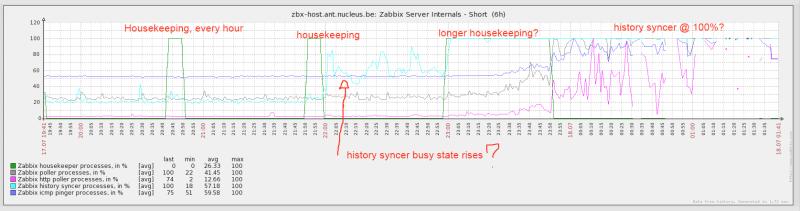

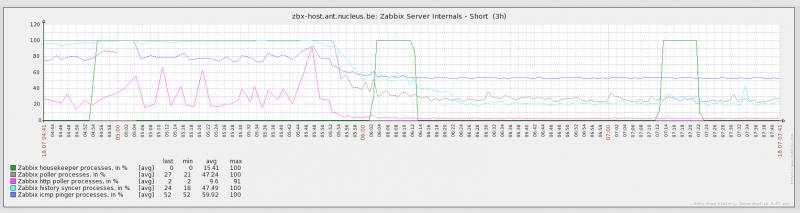

    To make this topic visually more appealing, and perhaps trigger some responses, I've attached a few zabbix graphs.
    The second graph shows that the "history syncer" process starts to occupy more resources (busy state rises to a 100% gradually), after which all other processes get to a 100% busy.
