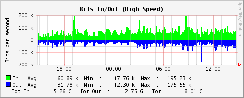

    So I'm looking for a way to graph data (like network through put) on a single graph but using the positive & negative sides of the y-axis. Much like the attached graph.
    I believe I've tried most every combination in the graphs setup. I was able to accomplish this by setting the eth0-in item with a 'Use custom multiplier' set to -1. This just set the incoming rate to a negative number, which is not ideally how I would like to do this.
    Can zabbix do this? Did I over look something simple?

    this has been asked a few times, but, unfortunately, not possible yet. could you please create a new feature request (i couldn't find an existing one) ?
    thanks

      Thanks for the confirmation. That's what I was afraid of after the 30 min or so of searching yesterday.
      Feature request @ https://support.zabbix.com/browse/ZBXNEXT-943
