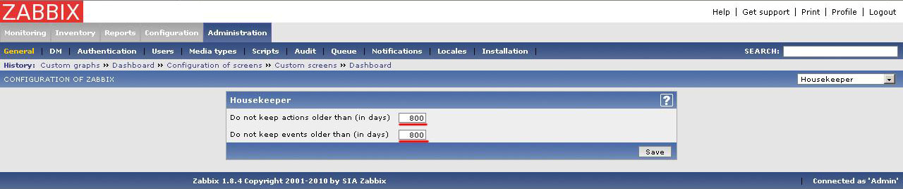

    • Davidus
      • Dec 2010
      • 281
      Whats yours?
