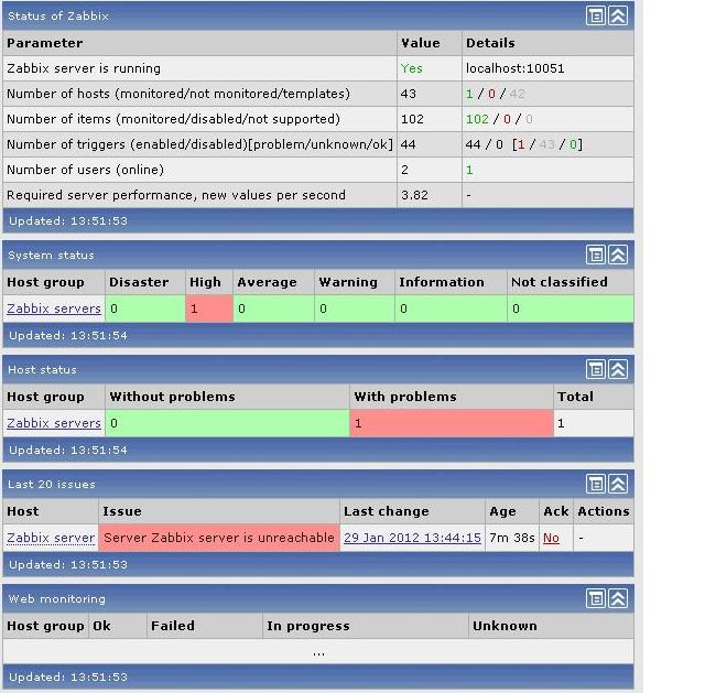

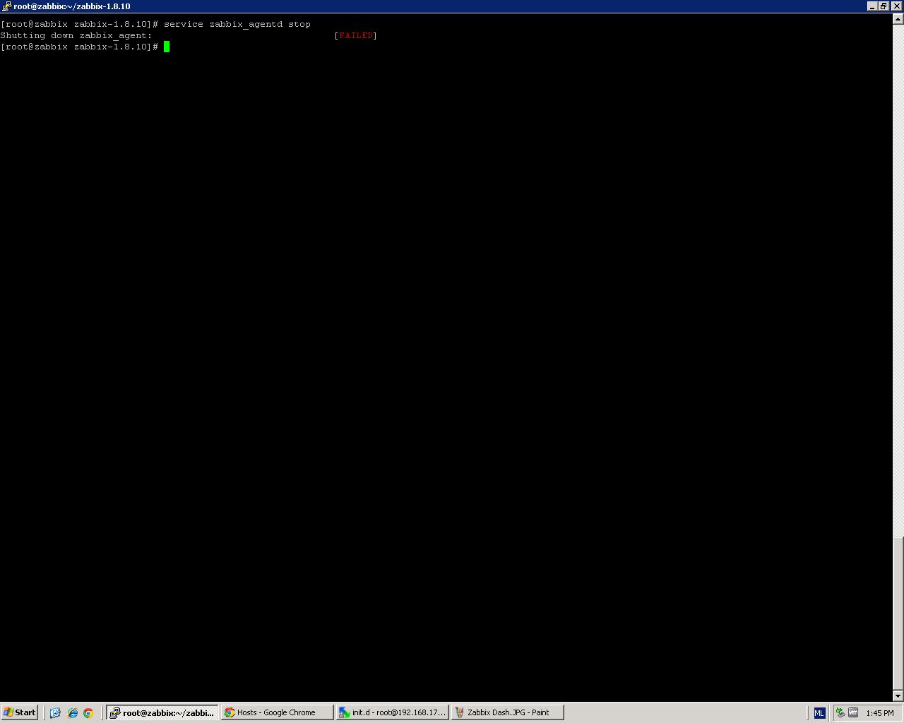

            So I've installed zabbix again following the attached previous document and the same problem occurs to me.
            I'm attaching screenshots regarding problem I'm facing with zabbix with zabbix, if I cant get zabbix_agentd to work is not going to work at all for me.
            The zabbix_Server starts
            The Zabbix_Agentd starts but when I type stop it fails.
            Advise if you need more information.
            Regards,
            Brian

              1. Check your start up script (most likely in /etc/init.d/ folder)
              2. Check zabbix logs
              Most likely your problem relates to inconsistent specification of the pid file in zabbix agentd conf file and your start up scripts.
              However it looks like a minor problem, you can just kill it
