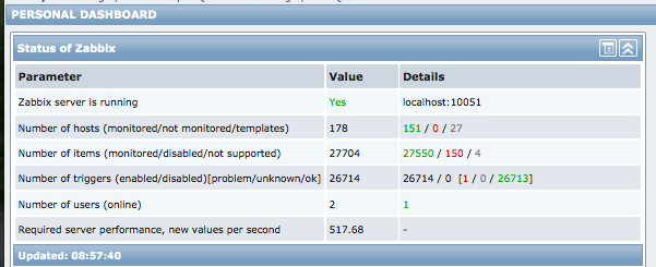

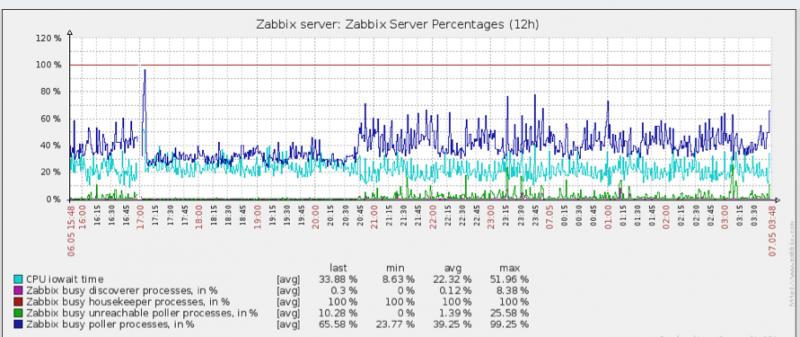

                Yes, thanks. What are the best settings for the housekeeping parameters in zabbix_server.conf for a postgres db for a large Zabbix installtion? We are running 150 hosts with 27,000 items on our test system, and the busy housekeeper % has been 100% for over 24 hours. Please see attached plots.
                [Edit]
                This is with HousekeepingFrequency=24 and MaxHousekeeperDelete=0, by the way. Previously we were using the defaults HousekeepingFrequency=1 and MaxHousekeeperDelete=500, which caused the same problem.
