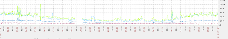

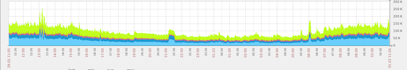

I am currently using Zabbix 1.8.9 and am monitoring Bind9 Queries, these are then shown on a Stacked Graph. The issue I am currently seeing is:
- In the stacked version, there is no gap shown where no data was collected, it seems to have bridged that gap - is this expected/ normal?
- If I look at the underlying values through latest data, or if I change the graph to 'Normal' (i.e not stacked), then it shows correctly, meaning the gap where data was not collected.
I should also add that, I only notice this behaviour in the stacked graph if I the view is set to 1 day, if I zoom in or set it to less than 1 day, then the gap is shown as expected. I have attached both images here showing you what I mean, more clearly.
Thanks in advance,
P
