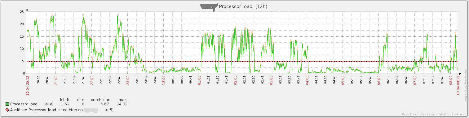

    I'm running Windows Server 2008 R2 as VM on Citrix XenServer 5.6 SP2. For monitoring the Server i use
    Zabbix 1.8.8 and the Zabbix-Windows-Agent 1.8.8 64-bit.
    The problem is that the system.cpu.load[,avg1] is too high. The Template is configured to trigger an alarm when the load goes
    over 5. Well, the MS Exchanger Server 2010 goes several times a day over 5, till 25 sometimes. That's not normal, isn't it?
    Could it be that Windows sends wrong or multiplied data?

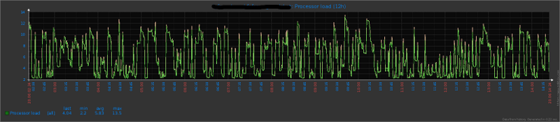

          I have exactly the same issue on several Windows servers, especially those running SQL Server (which is very CPU/Mem intensive). The strange factor is that those triggers firing up only started after I've upgraded Zabbix from 1.8.13 to 2.0.0!!!
          Any solution for this issue or have you just changed the item "Processor load" to "Processor util"?
