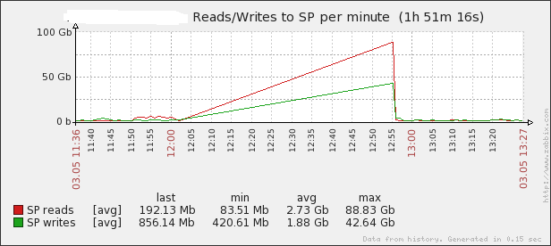

    We have a few graphs that show a spike or peak from time to time. I guess this user experienced the same.
    My analysis is that Zabbix was not able to read data for some time, after which it read a much larger value of the device.
    Here is some information about the analysis.
    The spike in the graph:
    Values from the database:
    mysql> select * from history_uint where itemid=46069 and clock > 1336039154 and clock < 1336042754;
    | itemid | clock      | value       |
    |  46069 | 1336039218 |  4341792000 |
    |  46069 | 1336039277 |  2724783880 |
    |  46069 | 1336039334 |   644267520 |
    |  46069 | 1336042515 | 88831519920 |
    |  46069 | 1336042577 |  1286807600 |
    |  46069 | 1336042635 |   154926200 |
    |  46069 | 1336042696 |   244149880 |
    7 rows in set (0.02 sec)
    The fourth value (88831519920) is much higher than the others, if you take a look at the clock value, you will notice there is a gap of approximately 3000 seconds or so.

    In order to get the graph right, I guess there are several solutions:
    1. Zabbix should not store the first value after a period of no-data.
    2. Zabbix should not graph the first value after a period of no-data.
    3. Zabbix should graph the average over the time of the no-data period.
    Does anybody recognise this behavior or have a solution?
    Regards, Robert de Bock.
    Your root problem is that zabbix server/agent does not get or are not able to get data for long time. You have to dig into that.
    Maybe the host your are monitor have real performance problems - e.g. look at other items for that host in same time spans.
    Br
    Erik

      I agree that it's a problem that this box was not responding, but there are different situations where the graphing could go wrong:
      1. A maintenance period without capturing data
      2. A planned reboot/upgrade
      3. Maintenance for the Zabbix server or database
      So, I still think the algorithm Zabbix uses to graph stuff is incorrect.
        This may be related even that it is data/sec:
        https://support.zabbix.com/browse/ZBX-4884
        (fixed in 1.8.13)
        /Erik

          I think you are right, that might well be the same problem. The solution would be to update to 1.8.13, which is stable. I'll try, thanks a lot for that link!
