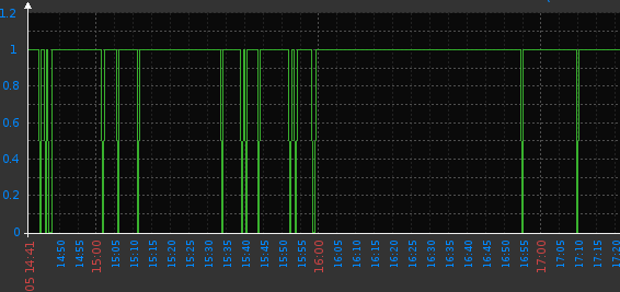

But since the upgrade, I am receiving way too many alerts that are solved instantly. When i go into the latest data, i can see "mini failures" in the results of the triggers (see attachment file) and therefore many alerts are send.
