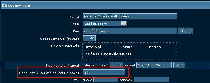

    I believe I read somewhere that you cannot manually delete them.
    if they went to an unsupported state, you can probably get rid of them by adjusting the "Keep lost resources" value at the template level on the "discovery rule". Change it to the minimum of "1", I guess.

      Though I'm not sure it will work, as the resource isn't actually lost. Zabbix is just requesting information from it which isn't available in the global zone. (Comparable to a host server in a virtual server setup.)
      I'll verify the result tomorrow and keep you posted.
