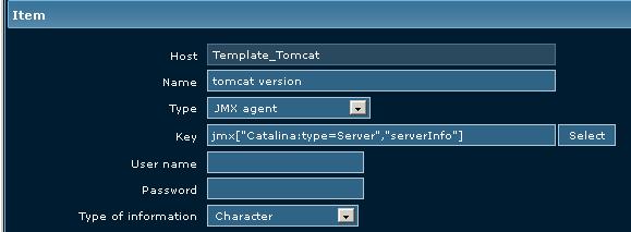

        Check how your item is set up. If I recall correctly, the stock Tomcat template was set to type Zabbix agent, and should be changed to JMX Agent
        Here is how mine is set.

          Yes, i´m using JMX Agent
