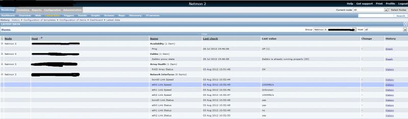

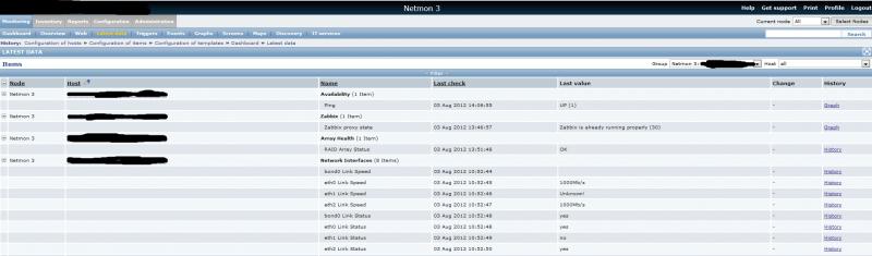

    I was wondering if anyone was experiencing the same thing here. I reported it as Zabbix bug ZBX-5413: https://support.zabbix.com/browse/ZBX-5413
    I'm encountering an issue with the history_uint tables not sync'ing to the master node at the same speed as the other tables, causing the integer values to lag/run behind, all other values are fine. This problem may only occur on very large installations, as the tables are actually sync'ing, just one table is sync'ing too slowly for us.
    I suspect that there is a limit in the code (didn't check this) somewhere, because all tables go over 400K bytes every now and then, especially when something big happens, except the history_uint table. I've never seen any sync of that table with a size hitting 400K, it's always something like 395K or so, while that table is running behind several days, and it's getting worse (it's a week at the moment and increasing, but the values ARE updating, just too slowly to keep up). Why isn't the sync sync'ing more data than 395K, when it's running behind that much? I should sync all missing data at once! If you look at the sync speeds, this is actually quite high, it takes about 2 minutes for a host to sync.
    Don't pay attention to nodes 5 and 6, they are not monitoring at the moment (temporarily suspended), that's why they are only sync'ing config, but no history tables.

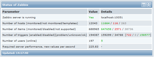

    Very large distributed setup, 1 master node, 5 child nodes, all on CentOS 6.2 64-bit, MySQL 5.5:
    Number of hosts (monitored/not monitored/templates) 12043 11664 / 116 / 263
    Number of items (monitored/disabled/not supported) 688965 647656 / 2571 / 38738
    Number of triggers (enabled/disabled)[problem/unknown/ok] 194100 159297 / 34803 [709 / 0 / 158588]
    Number of users (online) 197 5
    Required server performance, new values per second 225.83 -
