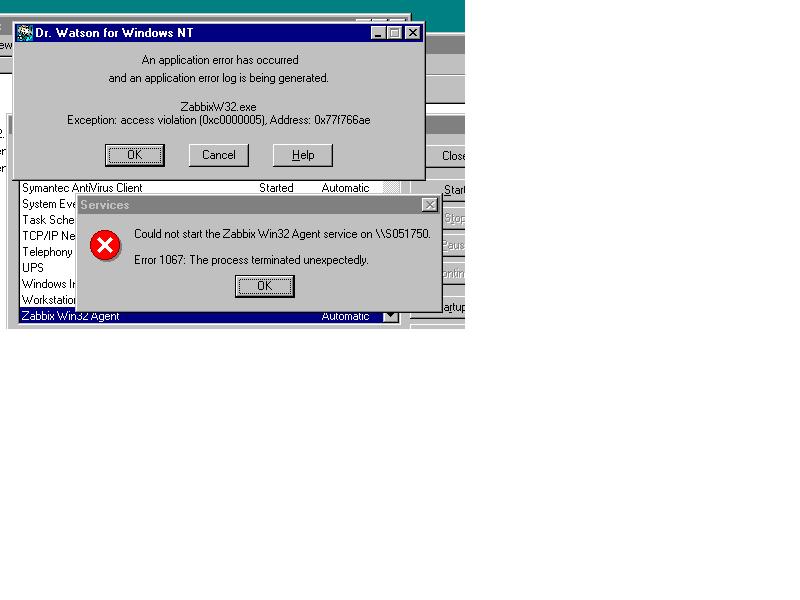

                      • befortin
                        • Jul 2005
                        • 48
                        Same problem here!
                        I have the same problem, but only with a Windows NT 4.0 SP6 host. I already got Psapi.dll registered. When I put the hostname in the zabbix_agentd.conf file, the service won't start.
                        Please see the attached JPEG for more details.
