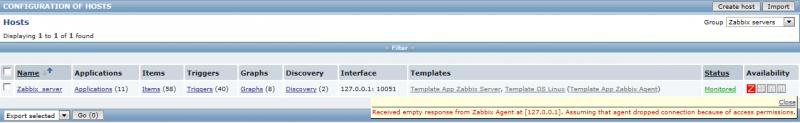

    But in the frondend of Zabbix, the dashboard is saying that zabbix agent on zabbix_server is unreachable. Under Configuration - Host, the Z is red and gives the following;
    Received empty response from Zabbix Agent at [127.0.0.1]. Assuming that agent dropped connection because of access permissions.
    Is there anyone who can give me advice/hint how to solve this?

      Maybe a image gives more input...

            Just saw the problem in your screenshot. you're connecting to port 10051. That's incorrect. You should vonnec tot port 10050

              Just to be sure;
              Zabbix_server is port 10050
              Zabbix_agentd is port 10051
              I can see what you mean. I'll work on it.

                By default, zabbix_server is port 10051 and Zabbix_agentd is port 10050. You have it backwards in what you just put here.
