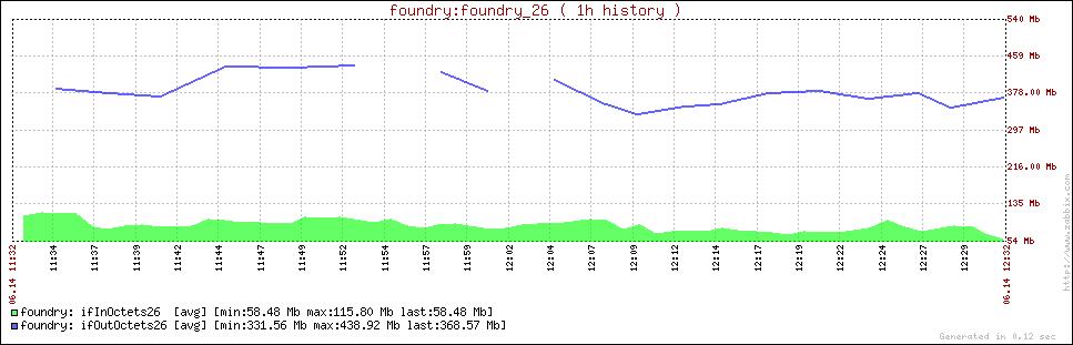

    I have the problem this as of 500 Mbits of the graph simply is not drawn any more and the measurements completely then slip to below.
    Example: http://81.3.14.227/zabbix/frontends/...om=0&width=916
    I use SNMP V2
    OID: 1.3.6.1.2.1.2.2.1.16.26
    Nummeric (float)
    Multiplikator: 8
    Perhaps does anybody have a solution for the problem?

      Can you provide a list of values for that item? and the graph of the same time period...
      I have a hunch it's not actually getting any values in that time period... which would indicate either a problem with connectivity to the device, or a problem with the software that runs the command...

        sure:
        17564 1149711661 476471841.9649
        17564 1149712022 456821443.0667
        17564 1149712324 457670226.0000
        17564 1149712625 462811629.3770
        17564 1149712923 461655810.1695
        17564 1149713224 445383012.8276
        There can i set the memory limit? php.ini ?

            hmm.. why do you use "float" for integer values?
            do you have any info about this items in zabbix_server log?
            • reifegerste
              • Jun 2006
              i change it to numeric (integer 64 bit)
              the same result
              No faults are displayed in the Logfile.
