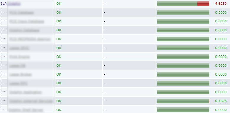

    For example the SLA calculation for the "this month" filter:
    As you can see the second from last value there was a problem: 0.1625%
    But the overall SLA calculatin shows a problem from 4.6289% <-- where is zabbix getting this percentage value from?

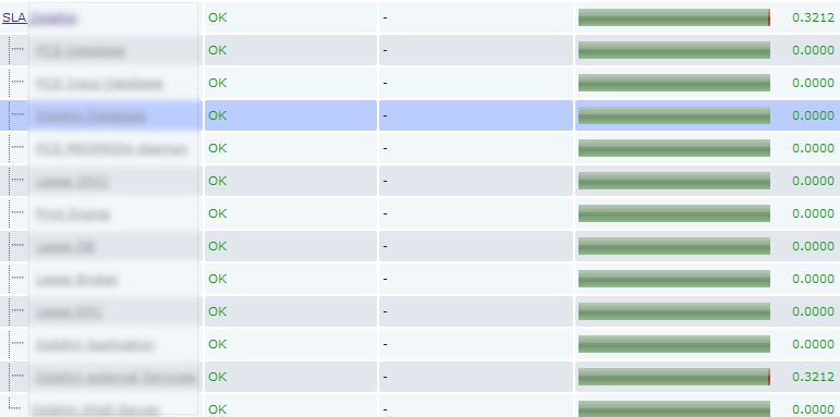

    another example is a correct SLA calculation with the filter "last7days"
    It shows a problem from 0.3212% and the overall calculation shows also a problem with 0.3212% for the last 7 days which is a correct calculation

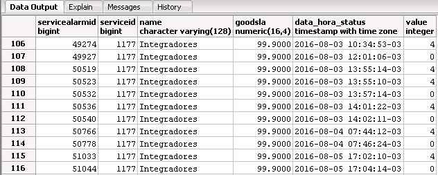

              I am getting the same same problem. I am using Zabbix 2.4.5, so look on this print screen, it is possible see some strange things in this query:
              In lines 108 and 109, I have the same status(4) in different times, but ServiceAlarmId 50519 report about a problem happened n 13:55:14, and ServiceAlarmId 50523 report about 13:55:10, a moment in time line before.
              ServiceAlarmId Time Value
              50519 2016-08-03 13:55:14-03 4
              50523 2016-08-03 13:55:10-03 4
              How is it possible the same Service(Integradores) get the same status in different time??

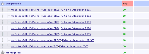

                How is it possible a root show triggered if their leaves are OK??
