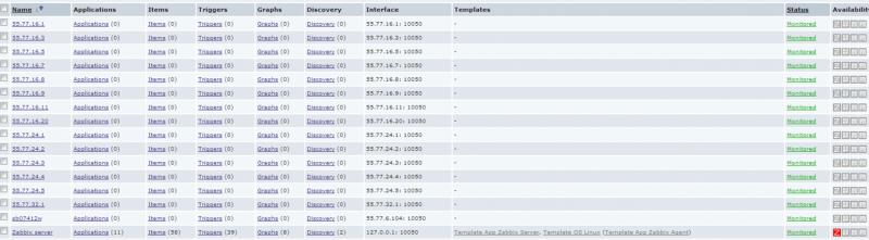

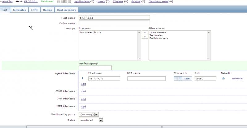

              I hope this is what you need cause i don't configure hosts. They are automaticaly populated from the discovery.
              For the moment, i created action to add host on hostgroup but not on template
              You can see on the hosts list that sb07412w have an agent but is not detected (in fact, the agent for the server is seen, mistack from me, sorry)

                            I see on your screenshot for ?Zabbix server" you have a red X. Hover your mouse over that X and see if it gives you an error message.
