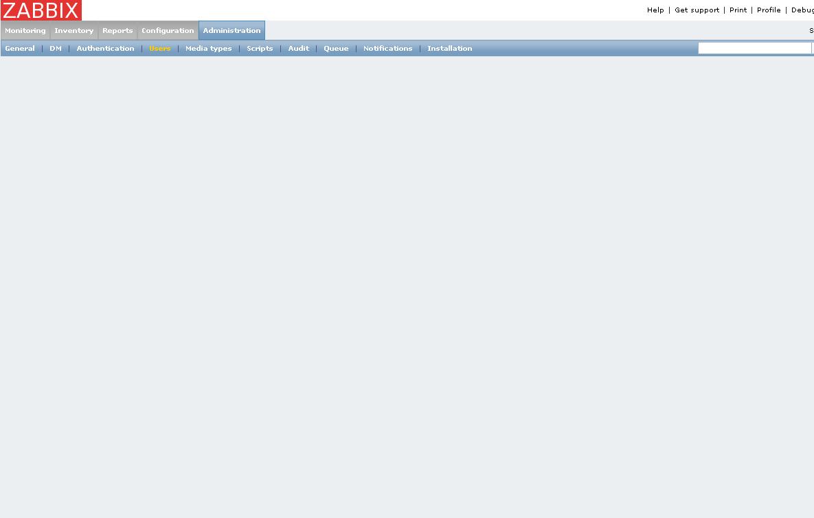

    After upgrading from 2.0.9 to 2.2 I'm unable to add a new host. Even cloning doesn't work. When I press save the interface hangs and does nothing just the top menus are present. If I refresh or click the top menu it's fine but host I tried to create is not there???
    Help.
    I cannot add new users. When I press save it is the same like when creating a new host.
    It looks like I can't save anything, even when editing trigger or template. Any Ideas???

    checked config files for zabbix server and php everything is OK it's like Zabbix is in read only mode ??? I can't edit anything, once I press SAVE that's it only the top bar is showing rest is empty.
