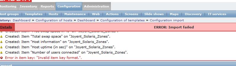

    I have a template provided by another party but I don't know whether it may have been designed for an earlier version of Zabbix or whether there is some other problem. I'm using version 2.20. When I try to import it, I receive the following error:
    Incorrect key: "Invalid item key format.".
    I don't know how to figure out which item is the problem. How do I troubleshoot a template import?
    Thanks!

            Here you go. Should work now. It was choking on one item and one trigger. I removed them. If you can live without the "SSH service is responding" item and associated trigger, then you are good to go. Attached as smartos_zones_2.xml
            As an FYI, here is the item and trigger I removed:

              For my learning...how were you able to find it was those sections causing the problem? Is there a log entry somewhere?
              Thanks again
              • tchjts1
                • May 2008
                • 1605
                You are welcome for the help. I imported it into my 2.0.9 setup. Any time there are errors, they will show on the "details" section of the import page. Just scroll down until you find the error. Should be this way in 2.2.0 as well.
                The entries are sequential, so we know that whatever is in the template after "Number of users connected..." is the one that is causing (at least) the first error. Checking in the template, it was that SSH check that was next. Remove that from the template and try another import. Then the trigger for that SSH check failed. Remove that and try another import. Success.
                That item and key could probably be adjusted to work. I personally don't know what the issue with it is just by looking at it. I would have to compare it to a similar key and see what's up. Don't have time for that right now though.
