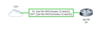

    Since the upgarde to 3.4.7 i have a problem width the Label of Lines in the Maps. Only when i logged in as admin the values are show correct.
    But when i look at the Maps as Guest, all Line Label values show only the macro-name instead fo the value...

    as admin:
    as guest

    I'm pretty sure that's a permission issue. Originally, Zabbix only showed users maps where they had access to every single element. That was a bit too rigid, so the loosened it up but some things therefore won't show. That's what you are facing, I think.

      I'm shure that you are right - it is permission issue...
      I found out that the macros only show the correct values, if a user with the usertype "Zabbix Super Admin" is logged in.
      A User with usertype "Zabbix Admin" or "Zabbix User" don't see the correct values.
      So now the big question: how can i solve the Problem?
