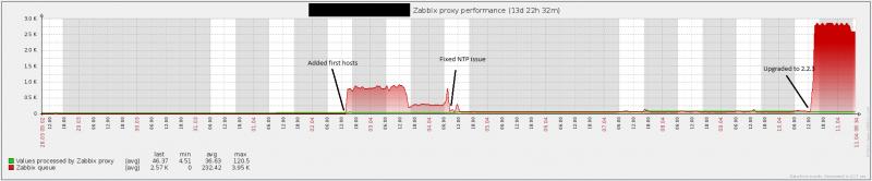

                Ok, everything seemed fine for a while.
                Now I've updated Zabbix to 2.2.3 and my proxy queues are larger than ever.
Name:	proxy queue.jpg
                Since I wanted to use the proxies mostly for scaling out, I just moved all the hosts to the server and my queues vanished.
                Anyone else seeing this problem also?
                Ticket: https://support.zabbix.com/browse/ZBX-8068
                With kind regards,
                Raymond
                  [ATTACH]6885[/ATTACH]
                  I haven't updated to 2.2.3 yet so I can't confirm the same behavior but it sounds like the same issue but possibly worse.
