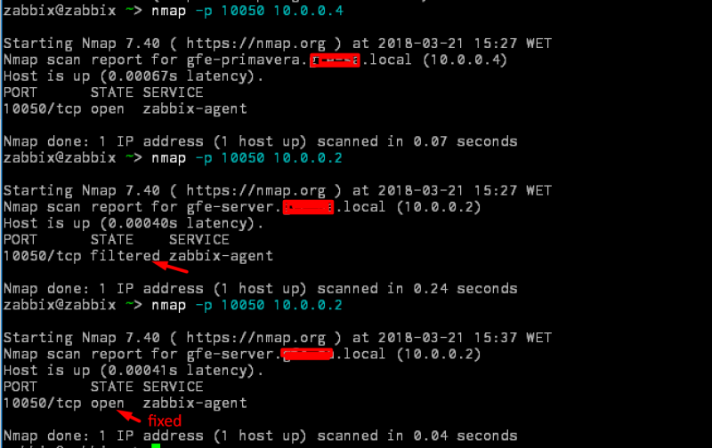

    And I have also used nc command doing:
    zabbix@zabbix:~$ nc -z -v -w 5 10.0.0.2 10050
    Warning: forward host lookup failed for gfe-server.x.local: Unknown host
    zabbix@zabbix:~$ nc -z -v -w 5 gfe-server 10050
    gfe-server: forward host lookup failed: Host name lookup failure : Resource temporarily unavailable
    And received those warnings but I dont understand why because this server can communicate through IP and DNS to intranet and internet, DNS is solving all links.

    I have done this process with active server active(did a copy paste of the conf file) on a Windows Server 2012 but I have added it manually in Zabbix server, and I was able to receive data from that host.
    • marafado88
      • Mar 2018
      • 27
      That port was being filtered in that server, thanks anyway.

        Zabbix agent in active mode does not listen on agent port.
