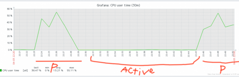

    I noticed while utilizing active checks that the overall metrics were not accurate. The performance graph below is when I was running a heavy install on the system. I noticed that just before the Zabbix agent checked in, the CPU usage would drop to roughly nothing, and then immediately spike back up to ~80 percent or so. During this timeframe, the agent had sent back that it was hardly under any load.
    I activated passive checking, and you can immediately see the graph grow reflecting its true results. Re-niceing and prioritizing the zabbix agent on my linux system (while running active mode) had no affect on obtaining accurate results. Below I have labeled when I was running active vs running passive below. Has anyone had any similar experiences to this?

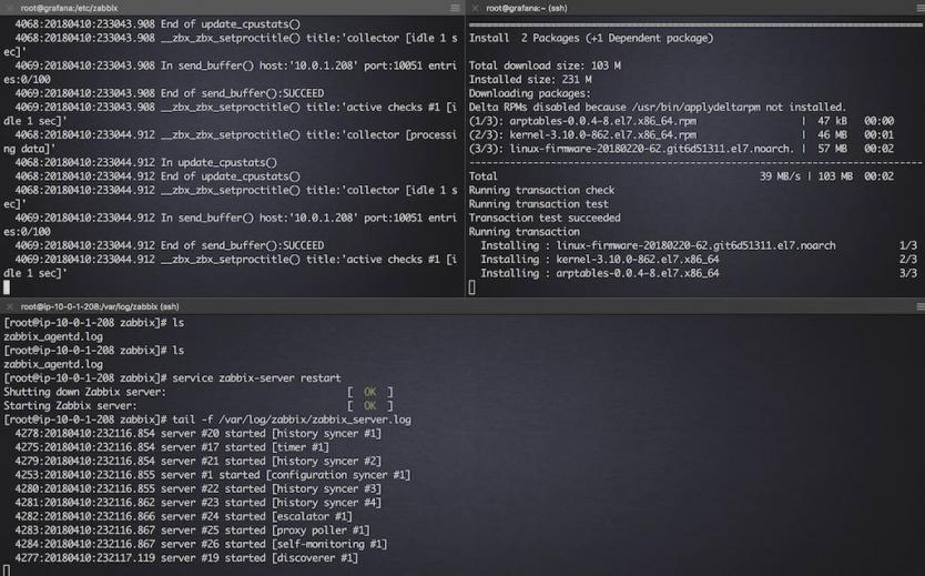

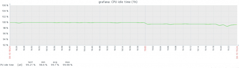

                    So I bumped up the logs to debug level 5, and here is what I am seeing. The upper left is a server with the zabbix agent logs set to debug 5. Upper right is the same server installing server packages. The lower terminal is the zabbix server itself. We can see that the CPU is barely reporting usage. If I switch this to passive it will shoot past 50%
                    Click image for larger version  Name:	zBfHHR7.jpg Views:	1 Size:	81.1 KB ID:	356915

                        Yes, the correctness of the data seems very different when the agent is checking into the server vs when the server is polling the agent. That is what this thread is about. Above the underlines of the graph show my instance installing all sorts of software. While that is going on, I switched from Passive to Active. Immediately on Zabbix you can see that the user time metric almost falls all the way flat. Upon switching it back to passive, you can see that the metric spikes once again
