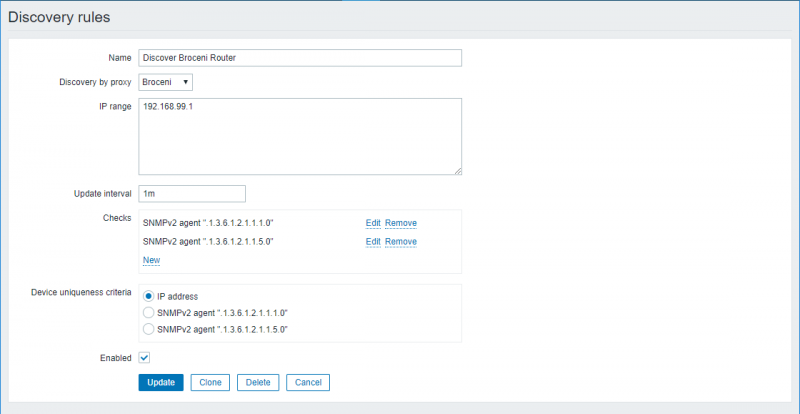

    Discovery rule:

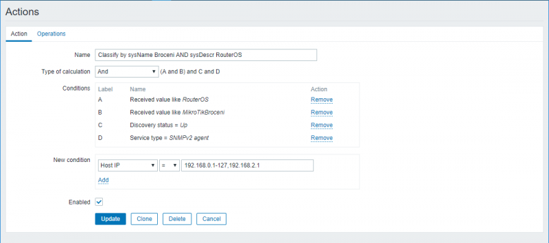

    And the rule which combines booth selections together.
    It almost looks like that condition works like:
    echo "output of all OID checks" | grep "$1" | grep "$2"
    I even tried playing with multiline regex like
    .*roc.*\n.*OS
    .*OS.*\n.*roc
    Once I am comparing to singe "Received value" then everything works as expected
    Any workarounds are welcomed.
