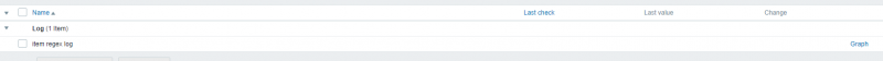

      The file is in 777 for the test and in the configuration I have no error . I add a print screen of the result trigger

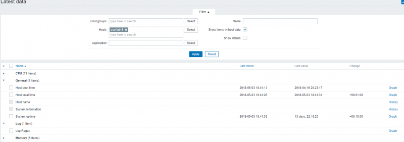

                    I made the change but still the same. I put the log of the agent in debug level 5 . is there a key or something I can search on the log.
                    I add a print to show that the other check are working.
