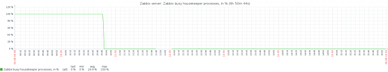

      We're running Zabbix version 3.0. I've attached housekeeper process graph. It did run beforehand. However, it went from 100% to 0 around 1 hour before the issue occurred. Can you tell me how to check, if I loose values of history write cache?
      When it comes to pinpointing the issue, i also think the problem is that the database doesn't keep up and it's staying behind. Do you know how could i check, if that is a valid assumption?
