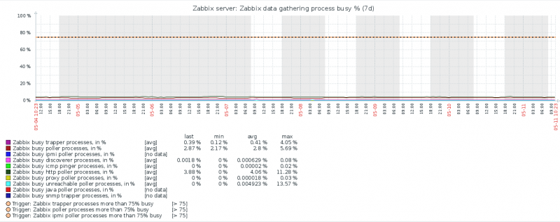

                If Yes, would you mind to take a look/comment/share the graph under Monitoring -> Graphs
                Choose Group "Zabbix servers", Host "Zabbix server", select Graph "Zabbix data gathering process busy %"

                  Sure!
                  Here's the graph of the past 7 days:
                  • aigars.kadikis
                    • Mar 2018
                    • 208
                    Originally posted by Abyss
                    Sure!
                    Are you monitoring all you server directly by Zabbix server or there is a proxy involved?
