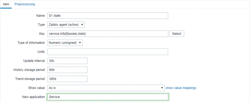

    On server 3.0 there is already built-in functionality for checking windows service state. Use function service.info[].
    There are a bunch state codes available to compare like:
    0 - running
    1 - paused
    2 - start pending
    3 - pause pending
    4 - continue pending
    5 - stop pending
    6 - stopped
    7 - unknown
    255 - no such service;
    Here is how you create item key:

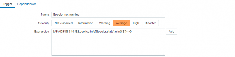

    And the trigger expression would look similar to this:
    {hostname:service.info[Spooler,state].min(#3)}<>0
