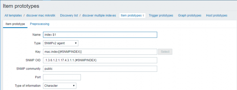

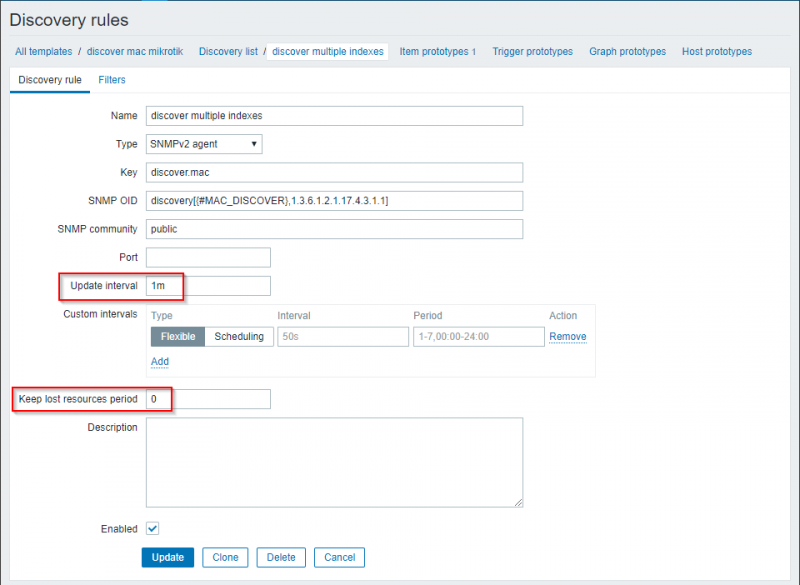

                In Zabbix we need to create an index discover:
                In your particular example, while detecting printer error messages, you probably need very short update interval.
                'Keep lost resources period' = 0 will automatically delete discovered items (messages) in Zabbix when the problem in the printer is solved, and there are no leafs available under base OID.
                Create item prototype:

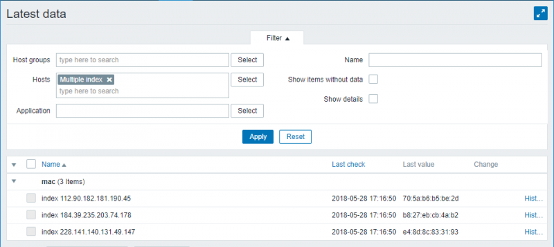

                Pure values are extracted:

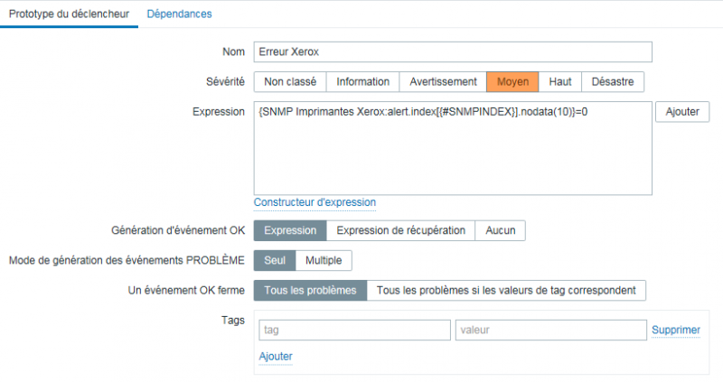

                    Perhaps this is my trigger which creates the problem ?

                      Please also share the screen with discovery rule.
                      • Theolude
                        • Apr 2011
                        • 13
                        See below the requested copy screen :
                        • aigars.kadikis
                          • Mar 2018
                          • 208
                          You need to name OID SNMP base like it was in my screenshot. It does not matter what you choose in this field. I would go with:
                          discovery[{#ERRMSG},1.3.6.1.2.1.43.18.1.1.8]
