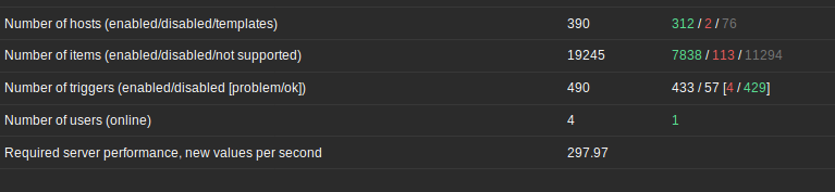

    pruned thousands of items:
    from
    to:
    The vps value almost dropped to half , but the queue still persists .

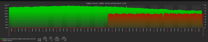

    The queue appeared when we inserted the new host :
