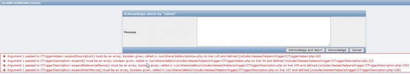

    I would like to have an URL in my Alert Email for accessing the acknowledgement page without opening the frontend first.
    /acknow.php?eventid={ITEM.ID}&triggerid={TRIGGER.ID}
    This URL does not work as I get the attached error.
    Thanks for any suggestions.

    Change your URL to be...
    PHP Code:
    acknow.php?triggers[]={TRIGGER.ID}&backurl=tr_status.php
    If you don't have eventid set (like it does on the dashboard), it expects a different parameter (highlight the link on the trigger status page and you will see this syntax)

      Works like a charm - Thanks.
