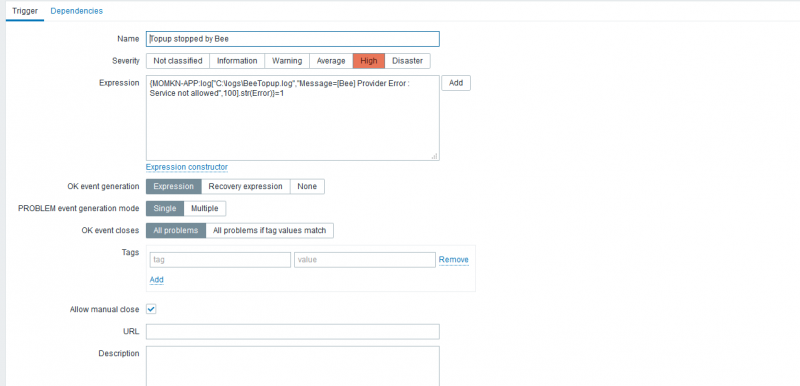

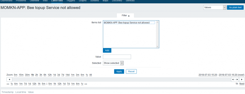

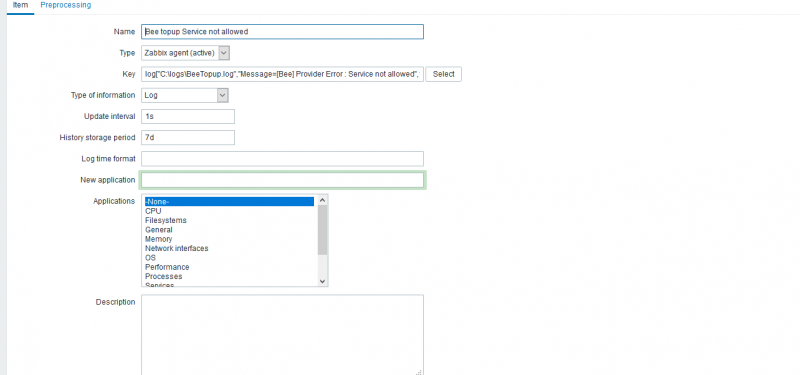

                Please attach the following screenshots:
                - latest data
                - item configuration
                - trigger configuration

                  • dimir
                    Zabbix developer
                    • Apr 2011
                    • 1080
                    1). You still have "100" as third parameter in item, remove it. 3rd parameter is encoding: log[/path/to/file/file_name,<regexp>,<encoding>,<maxlines>,<mode>,<o utput>,<maxdelay>], https://www.zabbix.com/documentation...ypes/log_items
                    2). I still don't see latest values of the item "Topup stopped by Bee".

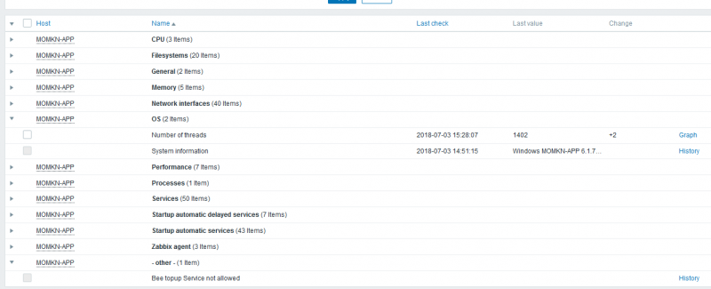

                    • seif
                      • Sep 2017
                      • 27
                      removed the third parameter in item , now item looks like below
                      log["C:\logs\BeeTopup.log","Message=[Bee] Provider Error : Service not allowed"]
                      i can't find latest value for the item topup stopped by bee , i checked latest data and filtered the item , screen shot attached Click image for larger version
                      • dimir
                        Zabbix developer
                        • Apr 2011
                        • 1080
                        That means you probably haven't hit that string after the latest changes. You can simplify the item e. g. log["C:\logs\BeeTopup.log"] to see if it gets the results at all.
